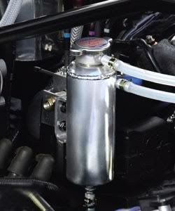

en sådan ?
"Designed originally for racing engines, today's compact production engines can also benefit from the used of GReddy's Radiator Bleed Tank. By mounting the tank high up in the engine compartment, you can be assured that of a fully filled system with room for air expansion, thus reducing chances of overheating due to air-lock. Hi-Pressure Radiator Cap included.
The air-removal tank is in parallel with the radiator. Once the thermostat opens, the hot coolant bypasses the radiator to pass through the tank, and is returned, hot, to the water pump inlet to re-enter the engine housing ports.
It's purpose is first to collect air/vapor in an upper, stagnant chamber. Then by thermal expansion of the fluid and gas, it purges the collected air into the vented overflow bottle by way of a 3rd hose that ends in the bottle below the coolant level. Air bubbles rise to the top and vent to the atmosphere. Upon cooling-contraction, coolant from the bottle is pulled back into the system.
The coolant that flows to the separation tank comes from the top of the thermostat housing, where a mini chamber is cast into the housing. The entry into this chamber can be seen after removing the fill cap as a 10mm hole. The only chamber exit is the hose to the separation tank. The purpose of the mini-chamber is to encourage any air that is passing below, from the open thermostat to the radiator, to rise up and be sent ( with coolant ) through the small bypass line to the separation tank."

den ser inte riktigt ut så, nipplarna är på varsin sida, och den ska placeras på variator skruvarna,
